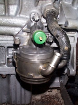

Get home from walmart and can smell coolent. Yep pop hood and then look under car and nice size puddle forming. Try to jack up car with make believe factory jack and squeeze my 6'3" 300lbs *** under the front of the car to see where the leak was coming from. I check the upper and lower houses from the top and both appear fine with no leaks....
Water is dripping off the end of the OIL FILTER ???
WHERE IS THE WATER COMING FROM? I mean I can see it coming down the oil filter and dripping off the end/bottom of it. ?? First thing that came to my mind was crack block or water jacket or freeze plug.

There is an oil cooler right above the pump. Start looking there and see if you can locate the leak. You'll probably need a mirror to see it.

ok took it to the local tire shop that I get all my stuff worked on and had them throw it up on the lift.......
well its not the gasket.... its hose coming into it! woooooooohoooooooo not sure which hose (inlet or outlet) but cause of the car they told me to go the ford stealer down the street and have them quote me the prices on the hoses and the repair. The wont touch the engine.
Parts @ Ford. $13 for one hose and $19 for the other.. And 1hr of billed labor.....@$75 an hour.
I would attempt it but dont want to have it towed down the street cause I couldnt get the hosed back on once off.......
But if thats all it is I guess its better then having them charge me an arm and a leg to repair the unit itself...
Does that sound right?? The house its split right at the clamp it would appear top of the house seems dry

To be perfectly honest, I don't think you even need a geniune Ford part in this case. There isn't too much bending going on w/ those hoses, so a standard straight hose should work fine with no worries of kinking. But Ford isn't going to do that, so I'd see if you can go back to the non-Ford shop and convince them to have a peek in there and just replace the hoses with off-the-shelf coolant/heater hose of the appropriate diameter.

There is a possibility that Ford may not have even used an "original" replacement part in the first place. I spent quite a bit of time trying to find the coolant lines that run into the firewall to the heater core and the connector that connects the water housing to the T-Stat housing on the rear of my V6. I got a lot of, "oh, Ford doesn't make SHO parts anymore." Gimmie a break. It's a hose!
When I finally spoke to the master tech at Miller Ford, he told me right away that Ford didn't even replace those lines when they went bad. Any metal lines were saved and the compression fittings were cut to fit off the shelf radiator hose and clamps. The connector for the waterhousing to T-stat housing I had to get a Honda upper radiator hose and cut the neccessary 2.5 inches off of the staight section that I needed and threw the remainder of the hose in the parts bin.
With that in mind, I'd go to the nearest auto parts store with a good assortment of radiator and coolant hoses in stock that yhou can look at and measure. Measure what you need, buy the appropriate clamps, and cut the hose to length. If you bring it to a dealer, that's exactly what they will do. It is a proper and acceptable repair.
