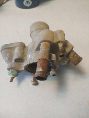

While replacing the thermostat today as part of replacing the oem radiator on my 90 MTX, even being very careful one of the studs snapped off. I need the coolant outlet housing if anyone has one. I'm in Woodland washington, near portland, oregon. I've reached out to shosource and am awaiting a reply, but incase they don't have one figured I would start looking. Thanks!

is it this one? this is on ebay now, says it out of a 93 3.2, $19.00
There is another one, but comes with more parts, but also from an ATX car
search for: SHO thermostat housing

that is the one, mine is a 3.0 mtx, not sure if this is same or different between the 3.2 and 3.0

If there is still some stud sticking out then remove what's left along with the other one and just use bolts. That's what I did with my 89 years ago.
