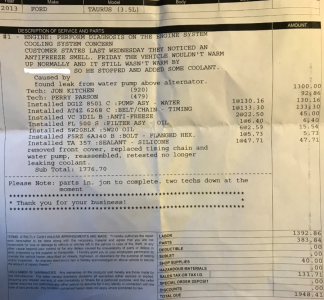

You can ask them which:
They take three times as many hours as Ford will reimburse for warranty service because they are incompetent;
They charge $250 an hour because they think they are top-flite lawyers or something;
They are criminals.
At 79K, dealership, look at how they don't even put down hours, they just make it up:
WaterPumpRepair
Ta2dResqr
Dec 10, 2020
1,208
1,144
Central Ohio
They are criminals.
A 2015 with 94k miles probably is not a warranty claim (unless he answered the call for an extended warranty). Labor time for the water pump is 13.4 hours. He stated they charge $150/hr which not that crazy for a dealership labor rate. $2010 in labor, add parts (pump $125.16, Gasket $5.40), fluids, shop fees, etc at dealership prices and I would say $2700 is not a crazy price. That being said, as he is doing, I would find an independent and get it done at a cheaper price.
