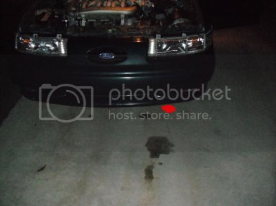

I cannot pinpoint this leak. It's been going on for 3 months. Even with my last radiator. What happens is that the car leaves a puddle of coolant after a park it and I end up having to put in another half gallon every week. I looked at my radiator and it is not leaking where the side tank crimps to the core. My upper radiator hose is so tight I'm worried if i go any tighter its going break the radiator. I have the TB bypassed and I've checked the radiator drain aswell.
I have attached some high res pics to this post. Red dots show where it lands on the ground when the car is parked.

In this last one you can see it all over my horns and ATX cooling lines.

this is kinda obvious, but are you sure the radiator drain c*ck is not leaking?
is the upper hose new? I had a hose with a pinhole a while back, that drove me crazy for a month until it leaked badly enough that I could actually find it.

The drain plug is tight as **** and not leaking. Plus with the way it looks under there it looks like its coming from a higher point. The Upper hose is new and I checked it for pinholes. I think that is leak is why my abs light turns on some times.... Seeing as all the connectors are wet.

The endtank leaks can be devilish to find. If one of the crimps on the front side in the middle is leaking, you might never see it with the radiator in the car. I hate to say it, but I think it's time to take the radiator out and fill it with water to see where it's coming from.
The 95's radiator leaked like a sieve for a while out the endtanks, but vise grips and a tube of RTV fixed that right up.
