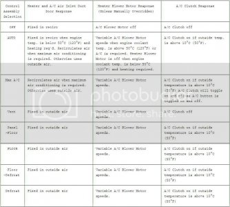

yeah, which I feel is crap. FWIW, the compressor won't turn on if the ambient air temp sensor says it's below 55 degrees. At least that's how it's supposed to work...

unless the eact is on vent or floor the compressor will turn on. that's what Ive noticed. its just the way ford programed it i guess.

As stated by BigBlock, The VENT and FLOOR settings (in addition to OFF) are the only selections that do not activate the compressor. You can heat the car's interior just fine with both of these settings.
