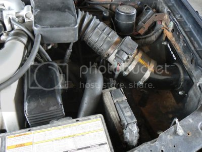

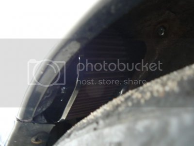

I think you guys are kind of silly.... you bend your exhaust into mandrel bends to help the velocity of the air going out, why not help it on the intake side as well... makes sence to me if you think of the motor as a big air pump.
Your saying this.... (don't forget to add the cone on the end of that peice on the right..)
P1060794
Flows as well as this...
P1060672 1
P1060671 1
I just have a problem with that... maybe its not so bad with just a 55mm MAF being your smallest restriction, but for the larger MAF's, I don't see how anyone can say it dosen't help.
P1060794
P1060672 1
P1060671 1
what about the dirt/road grim you're going to pick up with that set-up? not to mention the water and oil when it rains. i'm not saying it works or doesn't, makes sense that it would with less restriction but shouldn't you at least be running a pre-filter?

Well you have the inner fender liner in there also.... I'm sure that pic was taken after the install of it... and it wouldn't be that bad with it in there!

Yes, it does require more upkeep and maintance. Even with the dust sheild in place, it likes to collect a fair amount of dust. I'd say every 10k or so it could use a cleaning. More so if you live in sandy soil areas.
I haven't noticed it getting wet, but then again I don't take the wheel off in the rain when I get home from driving either. :)

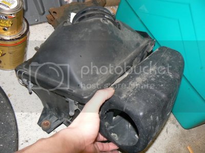

This is my setup. It definantly sounds, and looks better than the stock set up. I'm sure it doesn't gain much other than critisizm from people who don't like cold air setups.

Let me know if you need help, I've made 3 of these for different sho's over the years.
CopyofDSC05851

what did you use after the maf going into the fender? and what filter?
