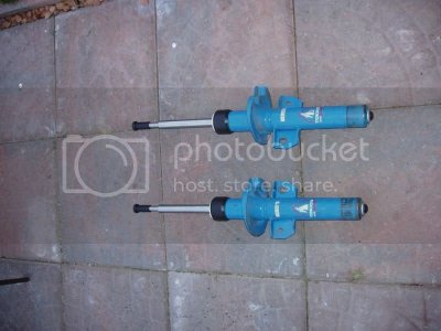

The short/long body only applies to stock Ford units. Any aftermarket units are one length only. Since you have Tockicos this does not apply. Also I am not sure if Konis will even install into the Tockicos.
Also we only have short bodies available which are the last remaining sets. So you have only one option available. If you can not go hunting for strut bodies we can install the Konis for you. We may even be able to prep them for the coilovers.

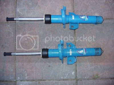

Here is where you need to measure if you were:

Koinis will install in the tockio front housings I have done that myself. I did not try the rears so I do not know.

Just needed to pull the tockio insert and drill a hole at the bottom the bolt will pull the insert in tight. You might have to use a longer bolt at first to get it to pull in far enough to get the bolt that comes with the strut to reach the insert then tighten the rest of the way.

I wouldn't be shocked if the rear fit in as well a few measurements would give you this info.
