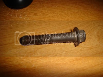

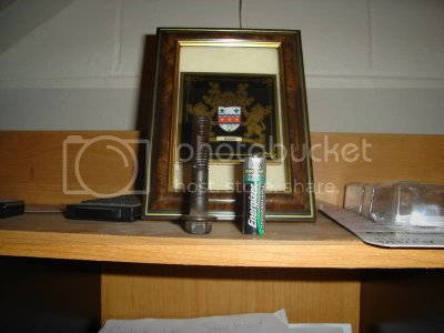

SASHO91 was right! There was something messing with the linkage!!!
This.
DSC00654
Size comparison.
DSC00659
So, does this look like something that should be holding my transmission to my engine to anybody else???? :madflame:
I'm off work tomorrow, and I'm out of class by noon. So, I think I'm gonna go raise some ****..
My best guess is that my "mechanic" didn't get this top bolt torqued correctly and it's managed to work its way out. It fell down and was resting between a piece of "webbing" on the top of the transmission and the linkage. Moved it, and everything feels as good as ever.
I'm going to look around tomorrow to see if I'm missing any others. How many am I supposed to be looking for..?
