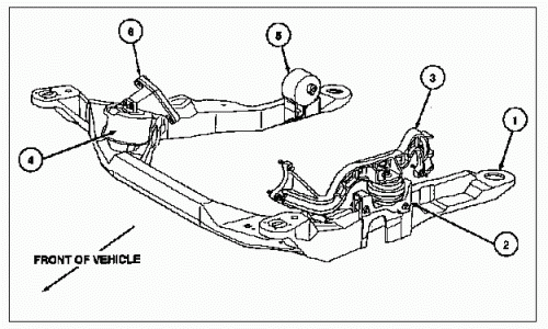

Mike,
I think you're a bit confused here. All the subframe bushings are on the front of the car, but there are two that sit towards the nose and two that sit near the footwells. When he said the one's in the rear had to be replaced, he was talking about the rearmost set, the ones under the footwells that are more prone to failing.
Here is a pic of the subframe, which is basicly an engine and tranny support frame:
Motormount1
The procedure for the subframe is at: http://www.v8sho.com/SHO/subframe.html
