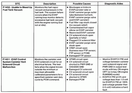

Well, I have gotten this code a few times in the past 2 months. Do I need a new gas cap?
I got this from v8sho.com:
Update41
Can someone translate this please :) ?

I was getting that for a while and cleaned off the cap and filler neck contact area with a rag. Haven't had any problems since last summer.
