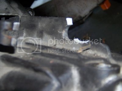

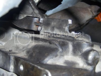

Well I accidentally snapped part of the housing of the tranny trying to work the dang thing out. The part specifically is where the the clutch cable goes through and snaps in place to hold it. I'm wondering if I can jb weld the two parts that broke or if I'm screwed and need to hunt the junk yards to get another tranny and hope that it wasn't abused.

I would think you could find a mobile welder, or a shop you can take it to and have it TIG'd back together. Pics?
Also, if you're interested I've got that case half, if you're willing to take the trans apart to change it.
I didn't think any type of weld would work due to the way it's casted. Will get pics later.

pjtoledo
'ol man in the SHO
Nov 28, 2000
2,782
371
toledo,ohio,usa
looks easily weldable

I will have to see what is cheaper, a JY tranny or getting this one welded. I do know this tranny works though.

This will help you with your clutch r&r. http://www.harborfreight.com/1000-lb-capacity-engine-support-bar-96524.html
It works as it should.
Best thing about it is once you buy it, you own it. I have used mine a couple of times now.
Here is a coupon code for 20% percent off : 16355144
As for the break on the trans, a good welding shop can easy fix it for a nominal fee.
