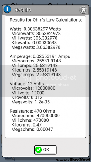

Also what's the wattage on that 470 ohm resistor? .5 or 1 watt?Uploadfromtaptalk1457738470095
