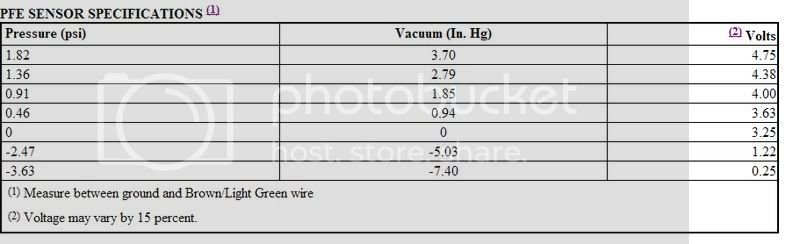

Here is a basic test you can check with a multimeter... with the car off
PSI = 0
so the volts should be 3.25, and when vacuum is applied (car running) voltage should drop.
