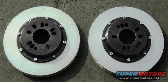

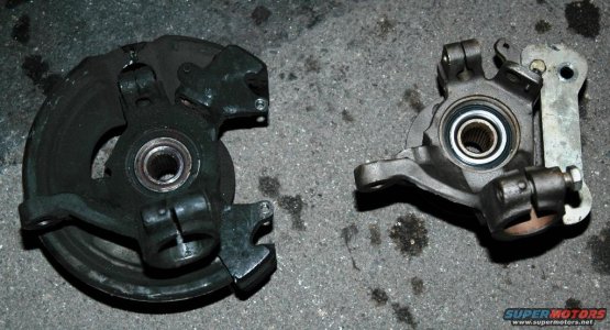

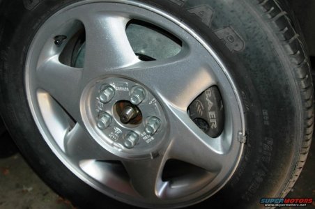

You can 12.5" Baer Racing kit under slicers. The kit is expensive, because the knuckles are machined and you need to grind the lower control arms slightly. I have a set on my SHO with custom 2 piece rotors from TCE which weigh one pound more than the stock 10.2" rotor. I lost 6 lbs of unsprung weight on each wheel. I also use bias plugs mainly because the TCE control arms have no way to hook the arm that that regulates the bias on the custom control arms. I haven't notice any tendency for the car wanting to swap ends.
Baer Racing installed with slicers:
Dsc 0032
Machined Knuckle on the right:
Dsc 0008
Custom Rotors:
Dsc 0022
