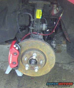

I went with the drilled/crossed drilled rotors and Thermoquiet ceramic pads. I used red header paint (1500 degrees) for the calipers. Brakes feel great!

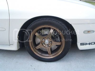

Those are 17 inch rims. I got the tires and rims for $250 so I'm not complaining... although I think the 225/45/17 are too small for the car.
I will end up replacing them with 225 or 235/50/17s later on.

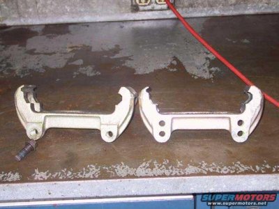

Here's what you need to do. The bottom holes are the original ones on the PBR brackets. You need to drill new ones up a bit. I then ground down the bracket and got rid of the original holes and lobes.
