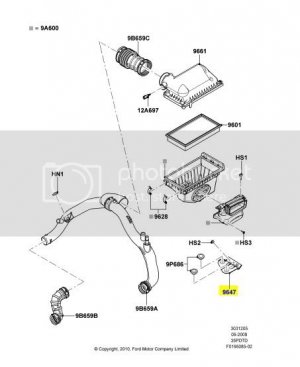

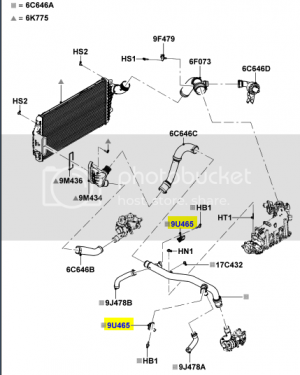

Blackwire1217
Dec 1, 2010
84
33
Florida
Hey, here is some information that should help with what your wondering about...
This is the intake track from the filter to the turbos
IntaketoTurbos
This is the intake track from the turbos to the manifold
BoostedAir

Nice post thanks. And to the previous poster I in know was interested in knowing the max boost or anything. I just want to keep the system leak free...thats all. Any turbo charged car will suffer from boost leaks.
I wonder if the dealer is capable of doing a turbo system pressure check procedure or something? I wouldn't' really care to perform a boost leak test on this car. On my SRT it's insanley simple but this twin turbo is another story lol.
SHOZ123
Dec 2, 2000
12,152
673
Illinois
There is still one point at the in and out of the intake track though. You should still be able to do an easy pressure check. If no leaks then move on to the individual intakes from each turbo.
