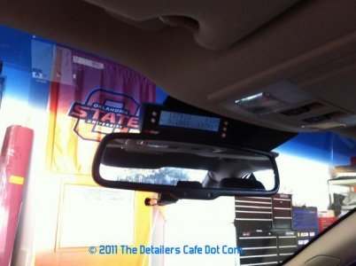

I am running a scangauge II ultra compact mounted above the rear view mirror on a blendmount. It works well as a solution until I can get a gauge pod I am happy with.

How many different metrics can you monitor with that? I see 4 simultaneous, but how many total possibilities? Looks like a fairly inexpensive solution.

I believe there is 18 or so pre-loaded, but it also holds up to 25 custom x-gauge settings, so if you can find the info for it, you can set up the custom gauge.
I have not been able to find one that works for Fuel pressure, or oil temp, but it works well for boost , water temp and AIT.
The gauge was $125 or so from Amazon, and the blendmount was about $55, but it comes with the additional Cat 5 cable that you need and a coupler. It took about 10 minutes to install the mount.
here is a link to the manual, and it tells everything it can display. It is a ScangaugeII version 6.0
http://www.scangauge.com/support/user-manuals/

I've been pleased with it so far. It occasionally gets confused, but all it takes it unplugging it from the OBDII connector when the car is off, then plugging it back in and all is well.
If I wasn't running the blend mount for my Passport also, I probably would have mounted the scangauge below the mirror, because I like my rearview mirror as high as possible, but it is not a big deal.
