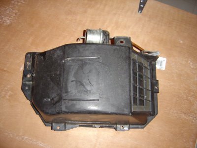

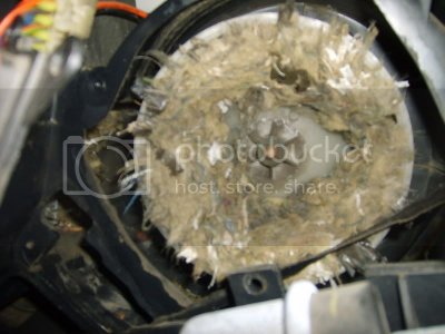

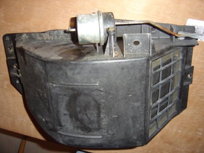

Make sure you have a small 1/4 drive ratchet handy, it's useful to get to some of the less accessible screws. It's not really that hard of an install. I also too the chance when I did mine to clean on the evaporator core a little and clean up the BCM. To get to it you need to remove the glove box/door assy, and the trim panel under the passenger side of the dash. You will then see a black plastic housing with a vacuum actuator on the top. This is the recirculater door assy. The assy is held on with 7 or so screws around the edge. Remove the screws and any vacuum lines and any electrical connectors that may be in the way, and then removing the housing. You will see the blower motor once you have it out.

Yay, at least I am going after the right thing. There must be at least 1 or 2 screws that I missed. I see I dont have to take that canister off. Think I might have to tap on it with a mallot? Thanks for the pics.

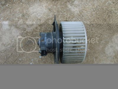

Black Stallion said:
Is the blower motor itself behind the wheel? If so how do I take out the wheel?
The motor is directly connected to the wheel. You need to take the motor/wheel assy out and then swap over the wheel.

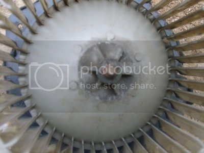

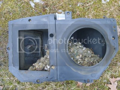

<a href="http://photobucket.com/" target="_blank"><img src="http://i102.photobucket.com/albums/m86/showtyme4000/Picture076.jpg" border="0" alt="Photobucket - Video and Image Hosting"></a>

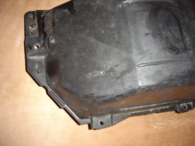

<a href="http://photobucket.com/" target="_blank"><img src="http://i102.photobucket.com/albums/m86/showtyme4000/Picture073.jpg" border="0" alt="Photobucket - Video and Image Hosting"></a>
How do I take these two apart?
