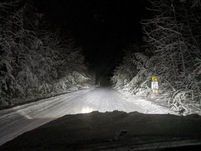

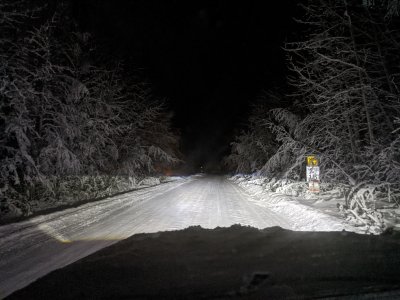

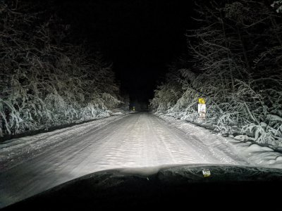

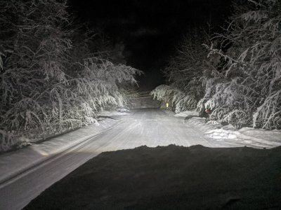

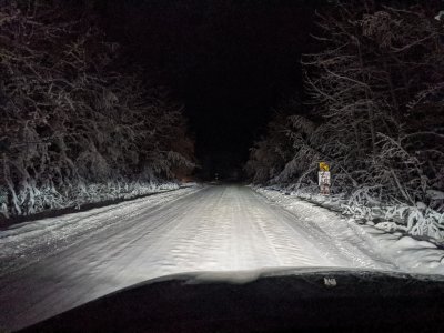

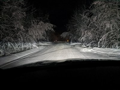

It's the projectors they are poorly made
The fxr is the best hid projector I know of https://www.theretrofitsource.com/bixenon-morimoto-fxr-stage-3.html
But not sure if they will fit but I'm sure any one will be better then we have

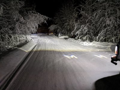

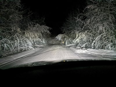

Then morimoto has a led retrofit that the led is built into the projector that I have installed on my f150 I'll have to get the two sitting next to each other to compare but the beam pattern is better and the light output seem just as good https://www.theretrofitsource.com/bi-led-morimoto-m-led-2-headlight-projectors.html
Sent from my Pixel 4 XL using Tapatalk
E94f4bbae3cd151c93ab2c102ea6bb2c
Long rd taurus hi8fc1abbda57fbf21a4e274a4b165a6f9
Long rd taurus loEa91345ee60fcad8c81b0161e83b443c
Long rd f150 hi326c22ed4e3330b934b3226b597c5572
Long rd f150 loF8aafd7219f96d583bc946a18da8a028557a2b023966a6df8789be1cbb8147f8
