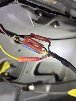

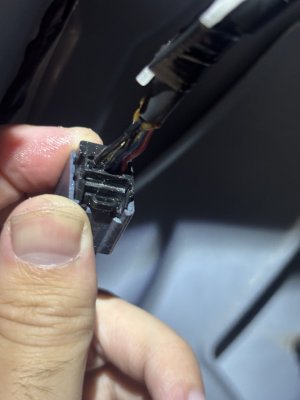

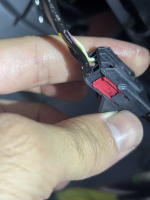

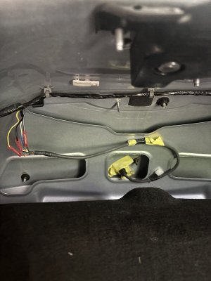

I have been having issues with the backup camera wiring and not working for the last year. I believe that water made it through the spoiler into the camera harness. I tried to clean off the years of build up to no avail. Today I clipped and striped the wires today. After a bit of work I was able to connect them all with wire crimps. The camera is now working perfectly. I didn't want to mess up after removing the harness so I put it off for too long. Worth the hour of work.

Make sure to tape those up well or you will have the same problem. I would have used solder connections, but that's just me.

I agree that electrical tape would be good to keep it sealed. For now it's parked inside and I looped my wire up higher to prevent any water that gets in from making it to those connections. I could solder them but that would be difficult for someone my skill level to not mess up the trunk or connections doing it. I would have done wire nuts and just tape if I could have.
