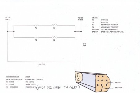

I can't seem to find the diagram for this modification anymore. I think it disappeared when the forum crashed. Does anyone have a link or picture for it anymore? Thanks

It's a mod that makes your ATX shift harder. It uses 2 resistors and 2 switches so you can choose how much harder you want it to shift. I think it was Axianator that came up with this modification.

After doing some searching around my house, I managed to find the picture that I was talking about. I had printed a copy a while back. So, here's a scan of my copy. It's not the best quality and it has one of my notes, but it is readable.

You can buy the same thing already assembled and ready to install. It is called an Adjustable Pressure Riser. www.oregonperformancetransmission.com sells them. Do a search on their web site for "AXODE PRESSURE RISER". I'm sure plenty of other transmission parts web sites sell them too.
