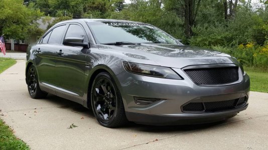

Suspension, pretty sure your only option for the '13+ is H&R. I have an '11 with coilovers. Seeing as no one has shared a pic yet, this is with coilovers not lowered all the way and is pretty similar drop the the H&R'S I think.
