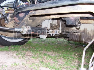

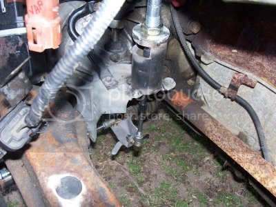

Im doing the MTX sho swap into a festiva. There are two ways to handle the shifter, one is to pick up a cable shifter from an early car ( some one will swap a rod shifter ime sure) and get some extra long cables from midwest cable, The you have to modify the shifter and tranny cable mount a little . Heres an early mock up
The other way is two take apart the rod shifter, turn the guts anround so the rod comes out the back, then you have to extended it to go under the engine. Its a ridged set up and I tried it but found the cable system easyier to do.
100 0913
100 0914
100 0915
as for the electrical pull the engine and computer harness, most of it will not be used but dont cut too much of yet, only a few wires realy need to be hooked up, power is about it. You would be suprised how much of the wiring IS NOT needed to make a sho swap run.

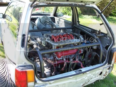

PM or email me anytime, I have most of the details worked out for this type of swap. heres a more recent picture.
100 1130
