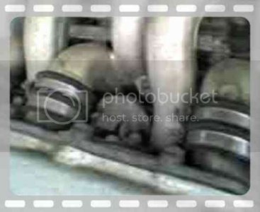

artifically loud but here mine.
Th 09 05 07 1640

Ya, I was thinking about sea-foaming it and running some injector cleaner.
Maybe I will try some of that lucas stuff too and see what happens.
BTW, timing belts is getting done as soon as I get the parts.
And I will order a new timing gear and woodruff key and do it all at the same time. just to be on the safe side :)
edit:
Just listened to the video, sounds about like that, not as bad, but you said it was artificially loud. Lets how its a valve. :)
