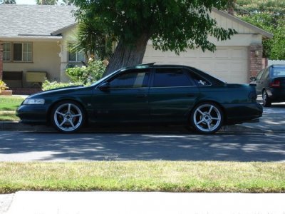

My '93 with Intrax
Dsc09056

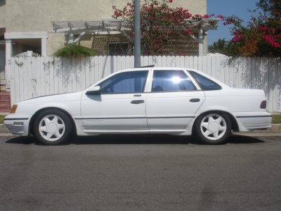

My '90 with Intrax.
Dsc00749

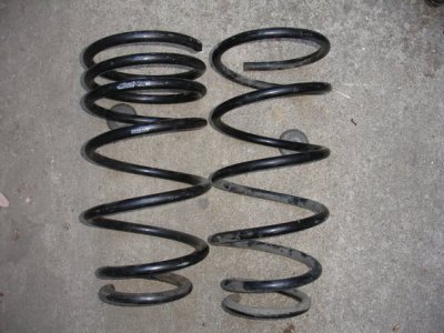

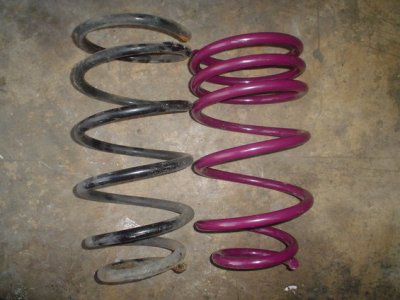

Progressive rate springs have "dead" coils that are closer together. Cutting those gives you a closer to perpendicular angle: top plane of the spring to the length of the spring
Eibach front spring next to Stock
Dsc06900
Stock front spring next to Intrax
Dsc00035
