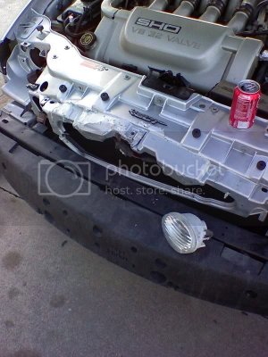

Yeah Ambient sensor is bolted to the fiberglass radiator shell and only (AFAIK) sends data to the Eatc.
030108 164600
I miss my SF painted radiator support. :(
