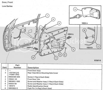

Ive gotten the whole interior pulled.. So far the only problem ive has is the door panels.. I cant get these little bastards off.. Ive taken all 6 or seven off. abd the sides pried off kinda easy.. but something in the middle isnt letting go.. WTF am i doing wrong?!!?
13,265
X2. There is a screw in the door handle that goes to a bracket attached to the door behind the door panel.

I also think there's another screw, near or below the elbow/arm rest (or whatever the **** it's called).

Yeah.. ive gotten them all...... rabble.. Like Tim (superho) said.. i aint pulln hard enough i guess?!

The first time you remove them, you gotta pull pretty hard. I always start in a corner and get them to pop a few at a time.
Also check the door lock plastic piece is removed or sub flush.

Same problem here. I gave up because i didnt wanna break the panel. I have the stupid special tools to pull the plastic clips and everything, found the hidden screws and searched that thing top to bottom, couldnt get it off. always felt like something was still securely attached.
