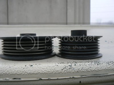

Yep.. that's what its looking like to me.. the snout is longer on the stock pulley... so... Im looking around now to see what I can cut up for a spacer... I'm thinking a 3/8 locknut will work.. possibly a 1/2" rigid coupling... or... a reducing bushing... Im going to have to get my electrical goodie box out.. see what I got.. AZ was a bust.. everything else is closed today..

Or... my epiphany of the day.... since I have 2 of these.. and the washers happen to fit, and two stacked up are right about .15 inches thick... then double up the nut on the pulley and be done with it?
:) Anyone think I should locktite it too? Blue? or red? I figure with 2 nuts it should be fine.. I dunno tho?
Edit : Test fit's ok... looks like it has a hair of a wobble tho... I'll see if I can't get the washers to sit opposite of each other or maybe bend them back straight. I suppose the alternator shop in town will have a spacer for something like this? I don't plan on running this long.. a few hours at best, but I figure it'll get me down the road, and right now thats all thats important.

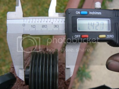

I have an UDP if you want it, I believe it has the longer snout that you're looking for. I stopped using it on my SHO when I started having charging problems. I'm going to try and find a pic of it now.

Here is a pic but it's not of the snout, I can take that tomorrow if you want.
