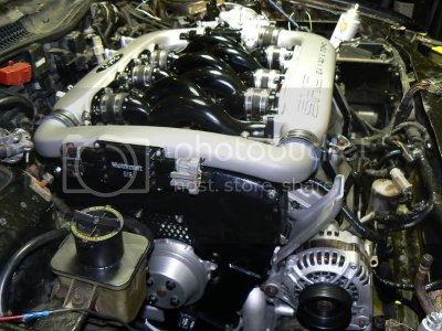

That looks about the same, my belt is kinda shot, got a new one coming tomorrow, so maybe thats the issue, but I would think a shot belt would be streched. It's so close to fitting over, but just can't quiet do it.
SHOguy 92
Sep 5, 2003
3,356
9
Duluth, MN
It's a UDP, took some messing with the tensioner and I finally got it on. And took a little prying to get the belt over the alt pulley, seems to run fine now though :thumb:
