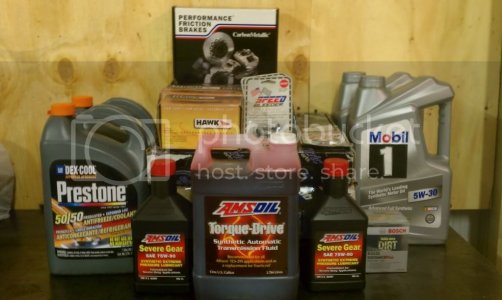

Anyways ive been preparing the car the best I can this winter. Holy crap........ I piled up my fluids and "expendables" for this and wat I need to do before febaury 18/19. All I Can say is WHY DO I HAVE TO PICK THE EXPENSIVE HOBBIES!!!!! Holy shit!! Lol Still need a few small thing but after this it should be good for a year of hpde's. hope to do 1 a month and autocross's in between :biggrin:
This is pretty much just fluid prep and pads/rotors. Ordering 8 bottles of motul 600 tonight so add that into the pic. Tires are not shown dont even want to think about that.

Good start!!
The Motul is way overkill, though, especially considering the price. For regular track sessions, Valvoline Synth or ATE will do you fine. If you boil those, you ain't doin' it right!!

I went with motul based on that most of the vette guys go with it. however from wat i've read the stock z06 are plenty good but are a weak point in stock forum. Heat is the problem. I went with good fluid, cooling ducts and ti shims to combat this. I know in the beginning it wont matter but i like to think in the future Ill be getting those puppies hot! money may force me to use a cheaper fluid 15 bucks for 500ml is not cheap!

3. Use a decent brake fluid. I'm still a fan of Castrol SRF even though it's muy expensive. Motul is not a bad choice. It'll still absorb water, though, so be prepared to change it out now and then.

As for brakes, I'd stay with Motul as it's an excellent fluid and should get you through a full year of DD/tracking. I always think it's good to get in there and bleed every so often, anyway.
I boiled the fluid on my '04 CTS-V and have run Motul, with success, ever since.
