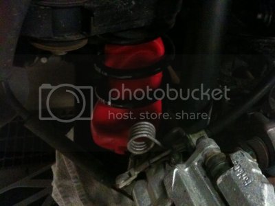

4. Again, the instructions are pretty good. You now exhaust the air out of the bag, replace the rubber cap on the stem to keep it deflated and squeeze it into the coil spring (This was the hardest part of the install).

5. After you get it in there its time to route the airlines. On our car we have a hole in the top of the upper control arm so you place the bag "stem up" and the airline feeds through the top. They are hooked to the bag over a barbed stem and spring clamped on.

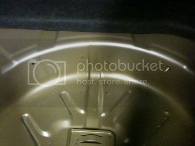

6. I ran the airlines across the control arm and into the spare tire well. Here's a pic with one valve installed and a hole on the other side.
5406c4b3
I installed it here because if they work like I want them to I may put a on board compressor in this space as well and run a wireless controller. After the install it's so easy to just hook a compressor up here at the track if I want. Takes about 1 second to inflate to 35 psi (Max) so I'm thinking I will probably skip the controller all together.

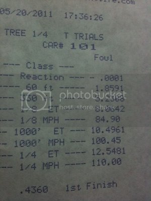

So....here's my update on the air coils. Went to the track tonight for the Friday night King of Street racing. Went basically to work on my reaction times and test out the coils since the air wasnt really conducive to bettering my 12.38 pass. Ran very consistent 12.51-12.54's (which I was fine with, staging deeper and working on reaction time mixed with the air I new my times would be down a tad)
Anyway back to the point.....they seem to work pretty good. My car launched better but my 60ft's were a little slower 1.82-1.88. Just need to work on the psi plus again, not sure about the air and track prep. I look forward to giving them some more testing before I'm sold on them for.
Speaking of reaction times.....check this one out!
Fb8aeb83
So ultimately I broke out running a 12.46 on a 12.52 dial in.....didnt really want the $500 anyway :angelnot:
