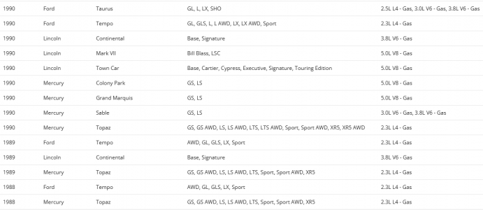

The air bag diagnostic module is a blue box attached to the passenger side A pillar, accessible by dropping the glove box door. Thermal fuses should be replaceable in the Gen 2s if you can find one (but not the Gen 1s).
I have the same issue with my 1991 Taurus SHO Gen 1. I’m told I need to buy a RCM Restraint Control Module diagnostic end. Part number from the Ford Dealer is FODZ14B056A. Im having trouble locating the part. Any suggestions?
PerryVog
Apr 25, 2024
Toledo, OH
Texas Marauder
Jul 20, 2007
906
817
Lone Star State
Probably only shot is finding a used one. Fortunately, it is used in many vehicles form 1988 to 1992. Start checking junkyards.
