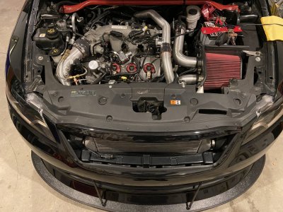

There’s no effect on performance if you VTA. A lot of folks just VTA and that’s what I did, even with EPP hot pipes I opted for stock BOV locations and just VTA. Some ppl buy the EPP hot pipes and get it with a TIAL bov as an option. FBD7A6E2 0923 4353 B196 6D72786A48BB

This isn’t vta so there shouldn’t be a negative impact affect on performance.
Unless you buy the Suction Return Kit and custom fab the return piping, this is a VTA system. If you use the kit listed, you will get the noise because it is VTA. They claim with the return kit, you will get more noise but, it will be muffled because it is going back into the stock piping.
