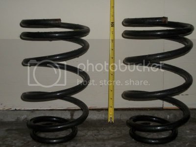

I'm getting ready to put quickstruts around my Green car and I've been thinking about swapping in some cut eibach's for the front.
Hoping the sensatrack's will be able to hold up.
These are the cut eibach's...
CutEibach
Can someone tell me if this spring will set my ride height right... too low? too high?
I'd rather find out before I install and put everything back together, IYKWIM!
