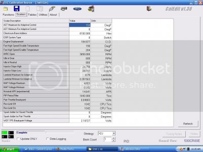

im having major tweecer problems. I put s stock x2j tune from josh's website on with the exception of the rev limit and secondary control. when i turn it to 1 where my tune is and start it the car jumps drops and stalls. i can put the tweecer on the stock setting and run perfectly fine. i tryed cleaning the computer and tweecer with no change. at first the tune i downloaded from josh said 27 for injector high and 72 for the injector low in the scalars. so i put them at 24.765 for high and 24.762 for the low. This is what hawkeye13 told me to do on the phone. That made no change in my problem but i plan on keeping them there anyways (those numbers make much more sense).
Heres a screenshot of my tune.

your "injector slope" numbers your using actually make less sense. heres why:
say you have injectors that are rated at is 48 pounds. thats 48 pounds when open constantly. so when your running WOT, and your injectors are at like 90% duty cycle, the ecu knows they are spraying 48#/ minute
then you slow down and let the car idle, your injectors are at like 5% duty cycle. your injectors, for most of the time they are open, are either in the process of opening, or in the process of closing, they obviously flow much less fuel during these times. the PCM has to compensate for this fact. its has to treat the injector as being much larger then it actually is
this is why High slope is injector size, and low slope is a much larger number
Bringing your slopes both close to the actual size of the injector is the preferred method (yes pring the low slope way down), however, you can't forget the step to lower the Injector Offset in the 12-14v region.

Correct, the offset does effect how the injectors respond at a given voltage. When you lowering the offset (in simple terms), you are causing the injector to respond slower, therfore leaning out the mixture. When I moved to 48lbs/hr injectors, I ran out of adjustment to the low slope and had to find a way to account for the large injectors.
If you adjust the offset, you will have to adjust the low slope as the first will effect the latter.

Also, shouldnt the tune from josh's website run just fine with no changes on my car? i dont understand why i should even be touching the injector slopes with stock 3.2 injectors.
yamahaSHO
E85 whore
Jul 25, 2002
10,646
Arkansas
With a stock 3L tune, there may be very, very minor adjustment. If you're running a 3L tune on an NA motor with just 3.2L injectors, it *should* start and run fine for the most part.
From the factory, the injector slopes are split far apart. You don't have to worry about making major changes to them until you go with larger injectors and if you go too large, you'll need to mess with the offset as explained above.

well i think i got it running right.
Whatever i put on 4 also goes to 1. so i had a9l loaded on 4 and i guess the x2j didnt like that.
So now im gonna try and see if 2 and 3 mimic eachother.
