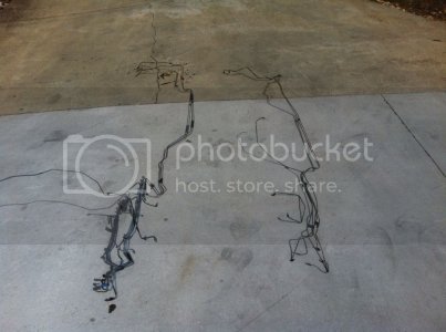

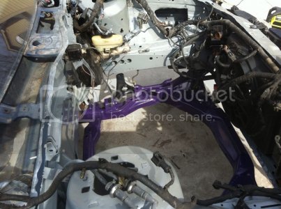

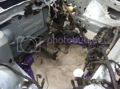

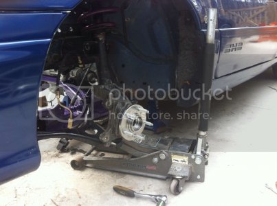

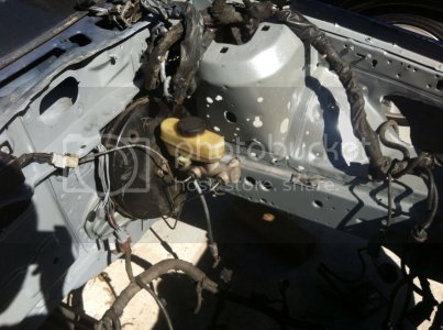

Ok well ill try not to be a total dick and will try to explain things.
I converted my drag car from ABS to Non ABS because it free's up space in the engine compartment, removes a LOT of wiring from under the hood and Drops the weight a little bit.
The easiest way is to find a NON ABS Taurus Doner car. and use the Booster, master cylinder and all the hard brake lines from the master all the way to the rear proportioning valve.
here is some pics.
Abs lines on left, non abs on the right.
