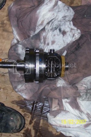

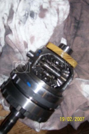

so i got a parts car, and gave the bad tranny to Mike (SHO'd) for a few bottles of 'mental anguish reliever' AKA beer. he proceeded to pull it apart and get to work rebuilding it. he sent me a few pics and a description of what he found.
the diff pin had been working its way out. that sound as i described earlier is most likely the sound of the fluid pump. i'm hoping Mike will chime in with a pic of that pump maybe. my guess is that tranny case shavings from the diff pin going around may have damaged, and or clogged the pump, stopping it... causing over heating of the tranny. the transmission pan has a magnet, however the case is aluminum...
