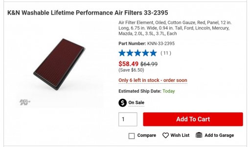

OK I thought it was more expensive than that. I’ll have to yank it out and take a look and see what I have. Perhaps I’ll take a picture and post here and get your advice on whether a water cleaning will work or I should get the kit. How much is a new one of these filters?

Here ya go

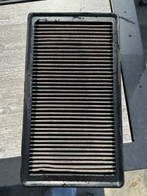

Thanks for that. I pulled mine out today and it didn’t look too dirty, but then again I’ve only ever used the paper filters which are very easy to tell if they were dirty or not. I’m attaching two pictures the top and the bottom before I rinsed it off. Didn’t look dirty to me and after using the hose water there wasn’t a lot of dirty water coming off of it so I guess it’s good for a while then. But let me know if I’m wrong please.Hash22405f8996f1e4ff9a8d52990da45d36

Gotta say u might need to recharge her. Not seeing a light pink. The person who put it in has cleaned it regularly.

IMO, K&N filters are over rated. With that said, hosing the filter off with water doesn't really do anything. The dirt is embedded in the filter and stuck with oil. The cleaning kit has a detergent/solvent which dissolves the oil and releases the dirt. Use a hose or faucet to flush the debris from the filter. Wash from the clean side to the dirty side to prevent further embedding of dirt. Do not use high pressure water or air. Let the filter air dry completely. May take a day or so. Re-oil lightly, every other pleat. Let sit for a while and look for any light colored spots that aren't oiled. Sparingly treat those spots.

Thanks all for you answers. I have ordered the cleaning kit.
