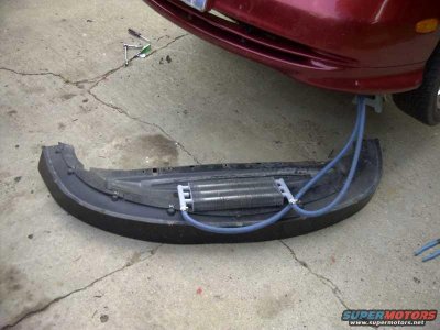

Yes, It is more efficient (effective) to a point. Generally, you're cooling oil on the water outlet of the engine (you're also adding heat to the coolant that the radiator now needs to cool). You won't get any cooler than what the water temp is and it's generally 190+ 190-220 is just fine for oil, however, I found that these motors can run warm as is. I elected to separate my my water and temp so that one does not directly effect the other.
This has helped tremendously as I have not had any issues with cooling in just about any situation I've put the car in since install. My water temp no long creeps on continuous hard driving and the oil pressures do not fluctuate as much at given RPM's.
I would personally suggest a frount mounted air-to-oil cooler with a t-stat. It'll take care of itself and the radiator and t-stat will take care of the water. Don't skimp on the ID of the lines used.

Yes it is in the picture I posted. It's a Hayden oil cooler I used to run the water through.

I didn't see the picture initially.
Personally, I think the better option would be to cool the oil without the stock unit. Cooling th water first is better than the stock setup though (however, unregulated).

Open track whore: Plumb in a remote cooler with an in-line Mocal thermostat. Are you running the radiator in the front of the car? If so, I'd suggest using -12 lines, as that's a pretty long run. In the thread linked by gmail, YamahaSHO posted a picture in post #79 of the block takeoff I fabricated for my remote oil filter and cooler.
