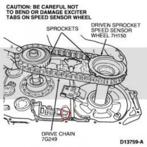

If all the other gears are working OK, it's blown a gasket between the chain cover and the transmission case. There pressure passages between the chain cover and the case to get fluid down deep into the transmission housing. One of these passages is Reverse Oil. It's on the end of the group and doesn't have a lot of support around it. Reverse is a high pressure gear and hits with about 150psi of line pressure. This pressure and the fact that the structure there doesn't have a lot of support and cause the gasket to slip out of position and fail. This leaks line pressure and reverse won't apply.
See this picture. I have circled the pressure passage in the case that supplies revers oil. As you can see, the closest bolt is a ways away, so the structure isn't really strong right there. The new '99 gaskets are thicker right there and keep this problem from happening again.
ChainDrive
When you take it apart, you'll proll'y find the chunk of gasket missing or hanging on by a thread.
