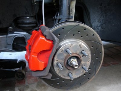

because either of the pads cover the outer area of the rotor, which is the most important part.
Except they don't. The difference in swept area is at the outside of the rotor.
'96 11.6" brakes with the small 601 pads, you can see the outside area that's not being used.
Dsc14162
The same rotor after switching to a 598 pad, you can see the outside area is now utilized.
Dsc00330
7,521
interesting photos - that is not the comparison I had when I looked at both pads. I only saw a difference on the inner part of the rotor. Apparently the pads from different suppliers are somewhat different in shape as well as thickness... from the comparison you show, I would draw the same conclusion as you have.
