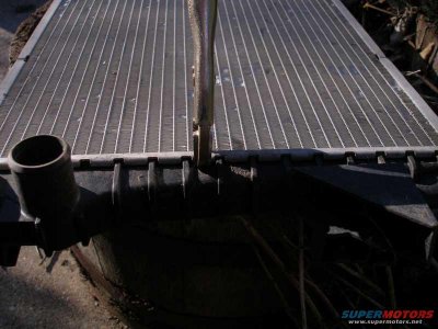

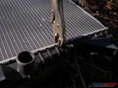

Just use a vise grips. Set it up loose and slowly tighten until you get the crimp you want.
SHOZ123
Dec 2, 2000
12,152
673
Illinois
Well you can really only do it one way. Not hard to figure out if you know how to use vise grips.......
But here's the basic concept.

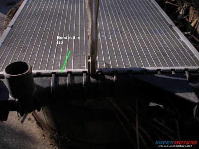

Mine is leaking at the side tanks also. What exactly are you suppose to crimp? I see in the pic, but I'm not understanding??
SHOZ123
Dec 2, 2000
12,152
673
Illinois
The aluminum frame of the actual radiator has the tabs that engage the black plastic tank. Just bend in towards the radiator the tabs a bit more.

Ahhh.....I see now. Thanks, I'll try that! Mine just started here when it got real cold, not it's really bad!

IIRC one of the repair mauals (Haynes/Chilton)told you what size drill (17/32 comes to mind...) to gauge the vise grips to. I had to do this every couple of months on my 94....

Well once the vise grips are set it is even compression on each tab. Just don't over crimp as it is a bed of foam gasket material that is between the aluminum tab and the tank.
