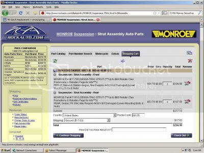

This look about right?
I'm not sure what you're looking for. I ordered the motorcraft struts from tasca.
