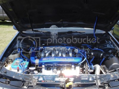

Well you didn't quite get the relay - but what you did was actually better (actually fixed the problem) so I'd say you did pretty good. The relay is a smaller unit... here, I'll dig up a picture of where it is.
DSC09061
See that little black thing, directly forward of the air box, and to the right of the ABS computer? It's got a mounting tab on the radiator support panel. That's the power relay.
In any case, there is an ABS code reading connector that functions the same way as the EEC test connector, and is actually right next to it. In the picture above, just below and a little to the left of the little trophy thing, you can see two black boxes mounted to the black plastic cover on the firewall. The one on the right is the ABS test connector, and the test procedure is, to the best of my knowledge, identical to the EEC KOEO procedure. The connector is identical to the EEC test connector as well.
