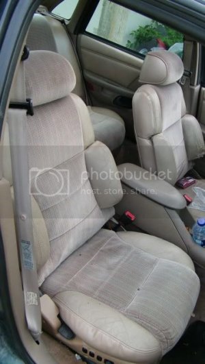

I worked on getting the interior pretty again this past Sunday and Monday.
7 hours total + a shop vac, a rug doctor, a toothbrush, a bunch of simple green and ALOT of elbow grease and the car feels 100% more welcoming.
The job is 85% done, I'm waiting on the next paycheck so I can get some leather conditioner.
I was very surprised how good the interior came out and believe my efforts were 150% worth it, can't wait to see/feel the leather after the conditioner.
Here's some pics I took in the middle, I'll put up final pics after the conditioner has been massaged into the leather.
100 1869
This is a good illustration of the cutting power of Simple Green, things were like this everywhere I scrubbed.
100 1872
The back seat was the most stubborn area as the dirt here was sun baked in and took some real pressure to get out, after a while i felt like I was wrestling with the car.
100 1873
A huge difference.
100 1880
This is way I saved the driver's seat for last.
100 1879
Once again, simple green works wonders with enough pressure and patience.
100 1878
I was messing around with the panoramic here, the head rest did get stitched out though, guess practice will eventually make perfect.
Once the leather is finished I'll post some before/after comparisons for anyone considering taking the time to do this.
I will say that the car feels so much more comfortable, if I haven't said it already, haha.

For starters here's my interior after finally receiving a conditioner treatment (I know the car is somewhat messy).

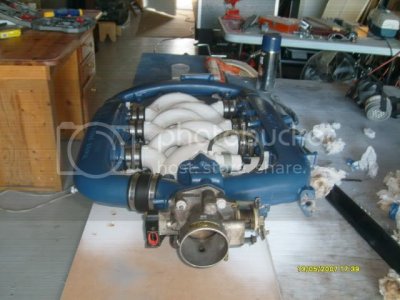

Took off and took apart the manifold then I gave it a strong detergent bath.
Figured I would go ahead with the color change i wanted to give it since it was already off and now clean.
I choose to use DupliColor High Heat Engine Paint, Primer, Deep Ford Blue, White, and Clearcoat of course.
S7300194

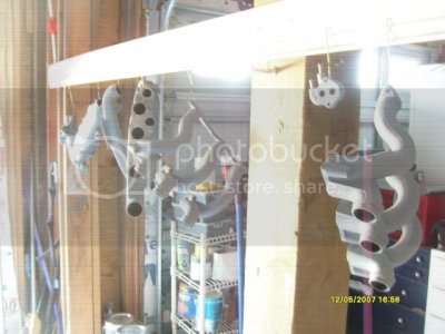

Day 1, disassembly :D
S7300204

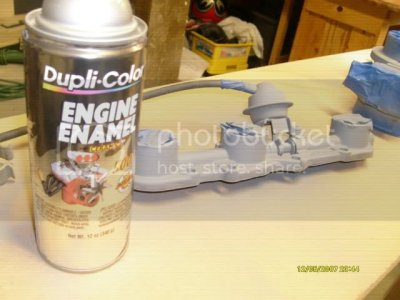

Primer. Nothing special.
S7300207
Getting the first coat on.
S7300210

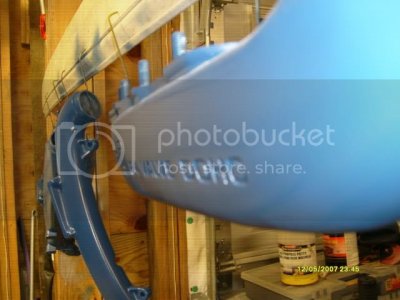

Right after the first coat of Clearcoat.
S7300208
The butterfly valves were a challenge to sand and prime but I got em'.

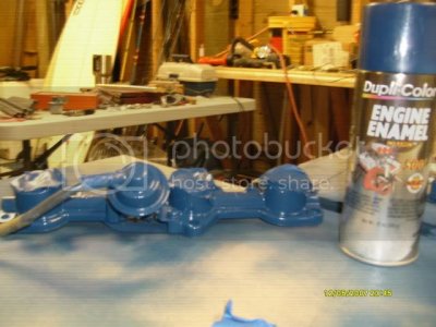

S7300209
Here they are after a good 2 coats of blue. Note the Paint choice for reference.
S7300206

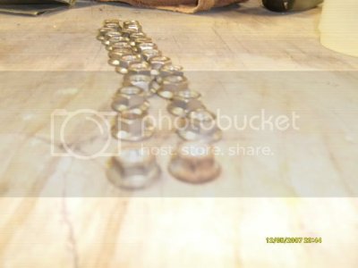

Although not very important I wire cleaned all the rusty nuts for a shiny clean look, it's the extra work like this that makes a difference for me.
S7300216
After a struggle to get everything back together here it is plus some scratches. :frantic:

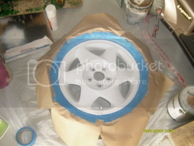

The weekend after I finished the manifold I went nuts with two cans of Duplicolor Automotive Ceramic White and Painted my wheels and the SHO rear and side emblems.
S7300148

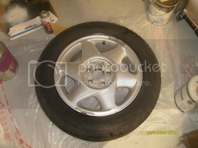

Although not noticeable from a distance these wheels had some history of abuse in the form of scratches, dings, and chips, so I took some bondo to the larger pits, chips.
S7300136
Here's the wheel between coats. Yes I primered twice along with 4 white coats and 3 clearcoats, all with 600 grit wet sanding inbetween.

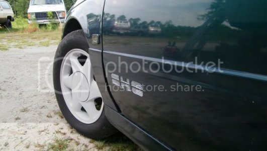

112 0005
Once I got every thing on I was liking the look. White is a pain to clean as I live on a dusty dirt road but worth it. I always get stares ( good I hope ) when I go somewhere.

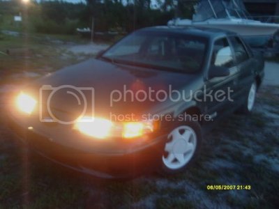

Here she is all buttoned up. After realizing how dim my headlights are I was ready for the headlight resto. I chose the Sylvania kit as it was on sale from advance and actually included with good ole' sandpaper and the works.

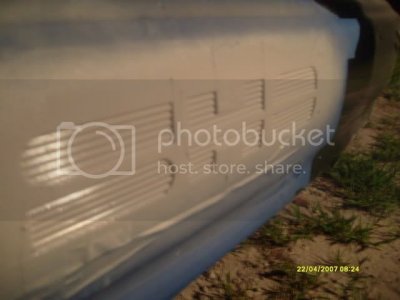

114 2048
The kit came with 400, 100, 200 grit wet sandpaper, masking tape,"surface activator", some wort of finishing compound, white application towels, the final clearcoat/polish with UV block and a glove for skin protection during application.
114 2060
Here's the final result, I am very pleased with this kit, there are still some nicks and pits that I could get to with 400 grit sand paper but it still is a great face-lift for my baby. I did take off the front plate holder as it was torn up, and yes I have black spray paint on the front to help conceal all the paint that had but scratched off from what i'm saying is the results of a careless driver.

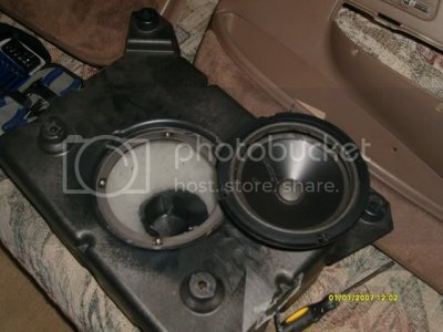

After getting tired of hearing the crapped out sub tearing apart I decided to replace it with the driver from my 3 yr old wal mart stereo.
S7300039
This is the old sub with a shot surround.
S7300045
After a little modification with a dremel I made this fit, after re installation I was able to turn my system up without hearing the old driver hitting the bracket.
But the sound was still lacking so I found time to install my nice Sony head unit, I bypassed the factory amps, and haven't taken the time to reconnect the sub woofer but the difference was great, even with the stock 17 yr old speakers ( and without the subwoofer) the radio comes alive.
