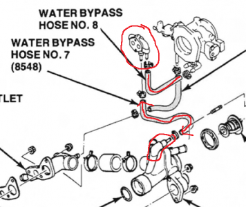

From the engine book I've been able to identify most of the coolant hoses at the back (left side) of the engine adjacent to the thermostat.
So far I can account for the following:
  • Water bypass #2 to the oil cooler (green)
  • Bypass #6 to the throttle body - not using (brown).
  • The outlet & inlet for the heater (blue)
What I can't seem to ID are:
  • A - large angled port out of thermostat housing (yellow)
  • B - small port out of thermostat housing (blue)
  • C - large port at bottom of throttle body (purple)
Any ideas?
image.php
TIA
hawkeye18
Sorta cares
May 18, 2004
5,631
2,727
Norfolk, VA
A is where the other Heater water line is actually supposed to go. See C for what that big hose you have labeled as the water line actually is. The fitting poking aft is labeled correctly.
B is what "Water Bypass Hose #6 to TB" hooks up to if you're bypassing the TB. You need to hook something up to #6, otherwise you will have a hot coolant jet out the side of your engine. This is "bad".
C is the TB intake for what passes for the PCV system on the engine. The other end of that is an equally large fitting in the cylinder head valley. I'm pretty sure the big long hose you have labeled as "Heater water line" up forward is what is supposed to go into C.

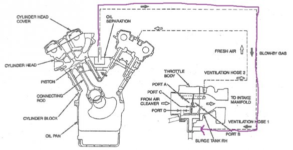

Here, this shows what "A" and "B" are supposed to be - from the build-up of my wife's '95 ATX.

Thanks confirmed my thoughts of my hookup. Also good diagrams. Thanks again Maurice

Jason,
Execellent. I totally forgot that the hose routed under the intake runners was in fact ventilation - which will be another questions I have down the road.
Your images make sense for all ports except the small one adjacent to the coolent temp sensor - the one I have labeled Bypass #6.

This should better show both of the hose locations. The big hose with no end is the PCV hose - it should look familiar to you! It also shows where the end of one of the heater hoses goes - labeled "A" in your original picture.

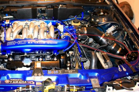

I highly recommend installing a catch can between that hose and the TB. You would not believe the amount of gunky shit that so-called PCV system will dump into the intake.
Here's an example of one I installed in my wife's '95. It's a simple can - the thin red lines show the routing.

3d914
Feb 1, 2008
832
338
Beautiful engine art Jason. If you didn't live in VA I'd come by and steal it from you. :angelnot:
BTW - where did you find the catch can?
Ebay IIRC. It's been powdercoated, and some other work was done to it - it had one of those stupid "sight glass" tubes that's just a clear plastic tube that breaks and creates a huge vacuum leak. We plugged them with huge-ass set screws and exhaust cement, and replaced the 5/16"NPT barbs with 1/2" barbs to avoid having to step the hose size down and back up again.
