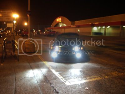

They all suck when you compare to mine. d2s baby:thumb:
