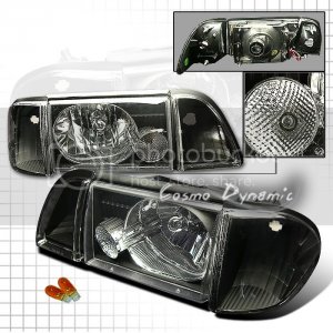

Fox Body mustang headlights

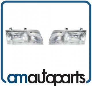

89-91 SHO(Taurus) headlights
E20f82304b
Looks like the GEN 1 lights are a little longer but then again a GEN 1 grill can be stretched to fit or a custom one installed in it's place. Get a set of the mustangs mounting brackets and such to make things easier.

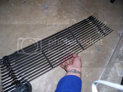

Grill1
Grill2
That is the grill, I made it from a navigator grill, the edges are still about an inch too big side to side, so after I get the headlights mounted I can grind it to fit nicely...
1154264337072 LCLHMUS87JMKS
Those are the lights I am using, I havn't gotten the projectors mounted or anything in the front clip yet, I have been waiting to finish the interior before I started on the body work... I chose the black to make sure I would not have any problems with strange reflections or whatever, plus its easier to hide the epoxy ;)... I will be using the main light, and the inner assembly as well, the corner lights will probably be painted black... One day I will finish the project and take a shitload of pics for ya ;) Still feel kinda funny about taking apart and cutting up my brand new 150 dollar lights hehee....
