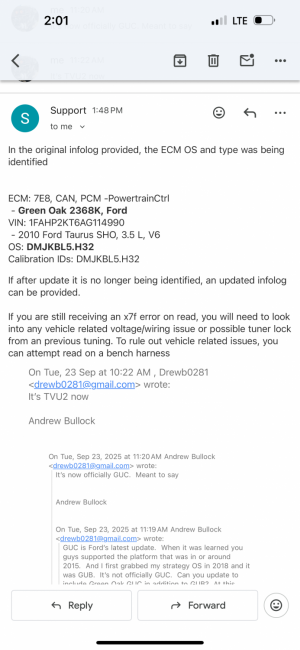

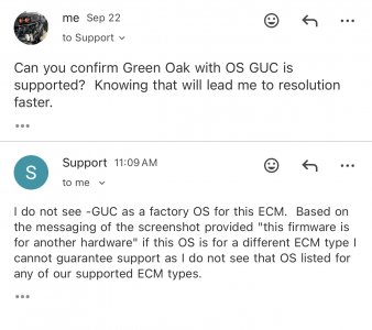

While waiting what seems like an eternity for HP support to find out about OS systems I decided to look myself. Fact: 2018 my system was GUB. Ok searching the internet HP Support for EcoBoost SHO’s surfaced in 2015. Ok so 10-12 had to be GUB. So unless HP updated their system to include GUC (for nobody bc I’m sure there has been no demand) it’s still GUB.
2018 I pulled this from my X4 awaiting my first tune.
ECU strategy code: DMJKB52.H32
SW Part ID: AU7A-14C204-GUB.
After the update for the transmission I saved my stock file to load Brads tune back. What happened? It changed it. Now the X4 reads
ECU Strategy code: DMJKBL5
SW Part ID: AU7A-14C204-GUC.
The tunes we used after that likely have gremlins designed for the revision old PCM GUB. Realistic next 30 days: Tune with Brad on SCT with the tunes based in GUC. Could be a breakthrough. HP will likely end up updating it. ETA unknown.
802SHO
Boost > VE, MBT, Cams
Oct 8, 2019
3,248
7,814
Essex Junction Vermont
I think this is my daily limit for today from HP 1 reply/day. IMG 5981
Finding out if they can add it. Should be type TVU2. The history is the 2010. I’m at Ford’s latest revision. 78018637725  469B8D70 98C2 44EB BD66 45EA8CF8A30FRenderedImage

Refresh my memory. A year ago we were talking about calibration BB4A-14D584-AC. Is that what got you to GUC or is that for GUB?
802SHO
Oct 8, 2019
3,248
7,814
It’s for GUC. And Ice figured it out. GUC is reflects its transmission up to date. More or less. My strategy is supported. Now I’m back to trouble shooting the stock read file.
AU7A-14C204-GUB (early 2010)
Softer shift scheduling (lazy 2–3, 3–4).
Lower line pressure → softer shifts, more wear.
Later TCC lockup, more slip at cruise.
Heavier torque management (longer spark retard).
Common flare / valve body complaints.
AU7A-14C204-GUC (update / TSB fix)
Firmer, quicker shifts (raised line pressure).
Revised scheduling (downshifts sooner, 5–6 more responsive).
Earlier, steadier TCC lockup (less slip, cooler temps).
Reduced torque management (shorter spark retard).
Required with updated valve body hardware.
