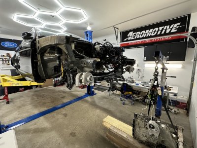

I’m a little late pulling the trans out but it’s happening this weekend! TBH it looked like a bomb of parts went off in my garage over the past few months. Took longer than I expected to clean things up and organize. I didn’t want to pull it apart in messy work area….i think if it more like a small shop now instead of a garage. Kevin is out of town until late Sunday night. Dropping the trans off to him Monday after work. IMG 0678

I’m a little late pulling the trans out but it’s happening this weekend! TBH it looked like a bomb of parts went off in my garage over the past few months. Took longer than I expected to clean things up and organize. I didn’t want to pull it apart in messy work area….i think if it more like a small shop now instead of a garage. Kevin is out of town until late Sunday night. Dropping the trans off to him Monday after work. View attachment 89835
I'm pretty excited to see this done. Your workbench looks kind of full. I can hold on to that stuff if you want. LOL

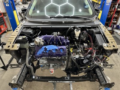

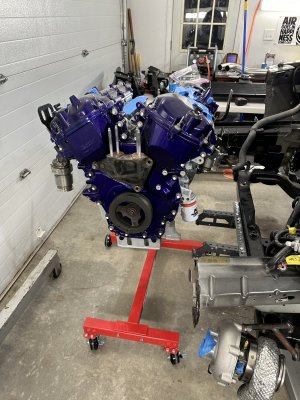

Getting closer. Not that it’s necessary but pulling the fenders and hood definitely makes avoiding a scratch to the paint 100% achievable. IMG 0689IMG 0688
The brackets up front are from the leftover angle iron from the garage door opener I took out lol! Makes a sturdy chassis splitter bracket

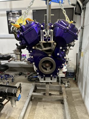

WOw that is the most wicked looking engine i have seen in quite a while its powered coated?inspiring me indefinitely..
SHOnion
Jan 19, 2024
39
21
USA
Translucent purple is the name of the powder coat.
I been wondering why more people don't paint their intake and valve covers like with so many other platforms,it really transforms the look of an otherwise mundane looking engine bay(In comparision to many of Fords other engines)

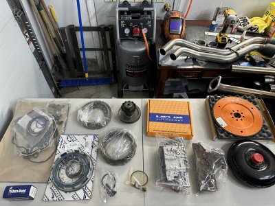

Transmission is now with Kevin. Next steps are to install as much as I can on the engine and take the opportunity to paint some body and chassis stuff. I have a couple cases of degreaser wipes and some Rostoleum Farm and Implement Weather Heavy Duty paint.IMG 0721

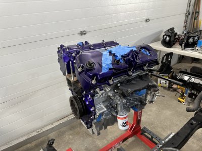

Gave my valve covers a little buff/polish/Adams Graphene ceramic coat. Xtreme-DI 2000cc injectors and XDI60 HPFP installed. Actually had to buy a new HPFP base plate and gasket as I couldn’t find mine. Went back to OEM old trusty ignition coils….just bc I wanted black to go with purple. Translucent purple looking more blue or purple depending on lighting IMG 0964IMG 0962IMG 0963IMG 0961IMG 0959
